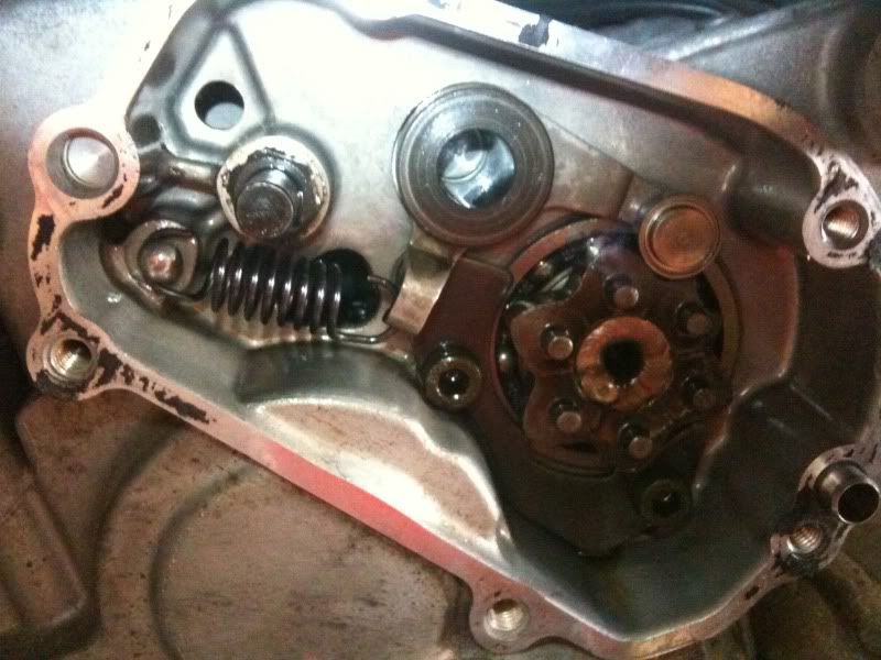

  11. So quick update i followed ur advice Dwc032 and i went ahead and started to work on removing the cover for where the tranny is.. I started by removing the cover for where the chain sprocket is and right above it is the tranny well i took out the shifter link and started to remove the screws that hold together the cover to where (i think the spring is) but started to loose oil and this moment i panicked :scared and wasnt sure if it was tranny fluid or just oil.. here are a few pics it looks exactly where i was working at but could someone reasure me it is so i can continue with the repair and get back on the road again :mrgreen:
    So this is the spring that you all might be refering to??
    [​IMG]
    And this is the location where it would be? Also is it regular bike oil
    [​IMG]
    Thanks for the replies and sry for the noob questions but i usually take it in for repairs except this time i dont have enough $$ to take it in just yet :roll:

  12. RedKat600
    RedKat600 Vintage Screwball Staff Member
    Um, this is slightly concerning. There is no tranny fluid for bikes unless you have a harley. That's why the manual never references it......
    Cool on the find though! bet that was the issue.

  14. Is that broken spring out of your bike or someone else's? That's the same spring that broke on mine, just buy a new spring and put in the exact spot that the other spring is in. I would change the oil just to be safeand dont worry about a little bit of oil in that area. My 98 has over 75000 miles on it and it still does 2nd gear power wheelies! Not as fun in the canyons as my 2005 R1, but still a sweet ride!

  16. That spring is a known weak spot in the R1 tranny. That spring has broken twice on my R1. Other then the spring the R1 tranny is bullet proof. BTW, I had over 10000 track miles on the bike before I put it on the street.
