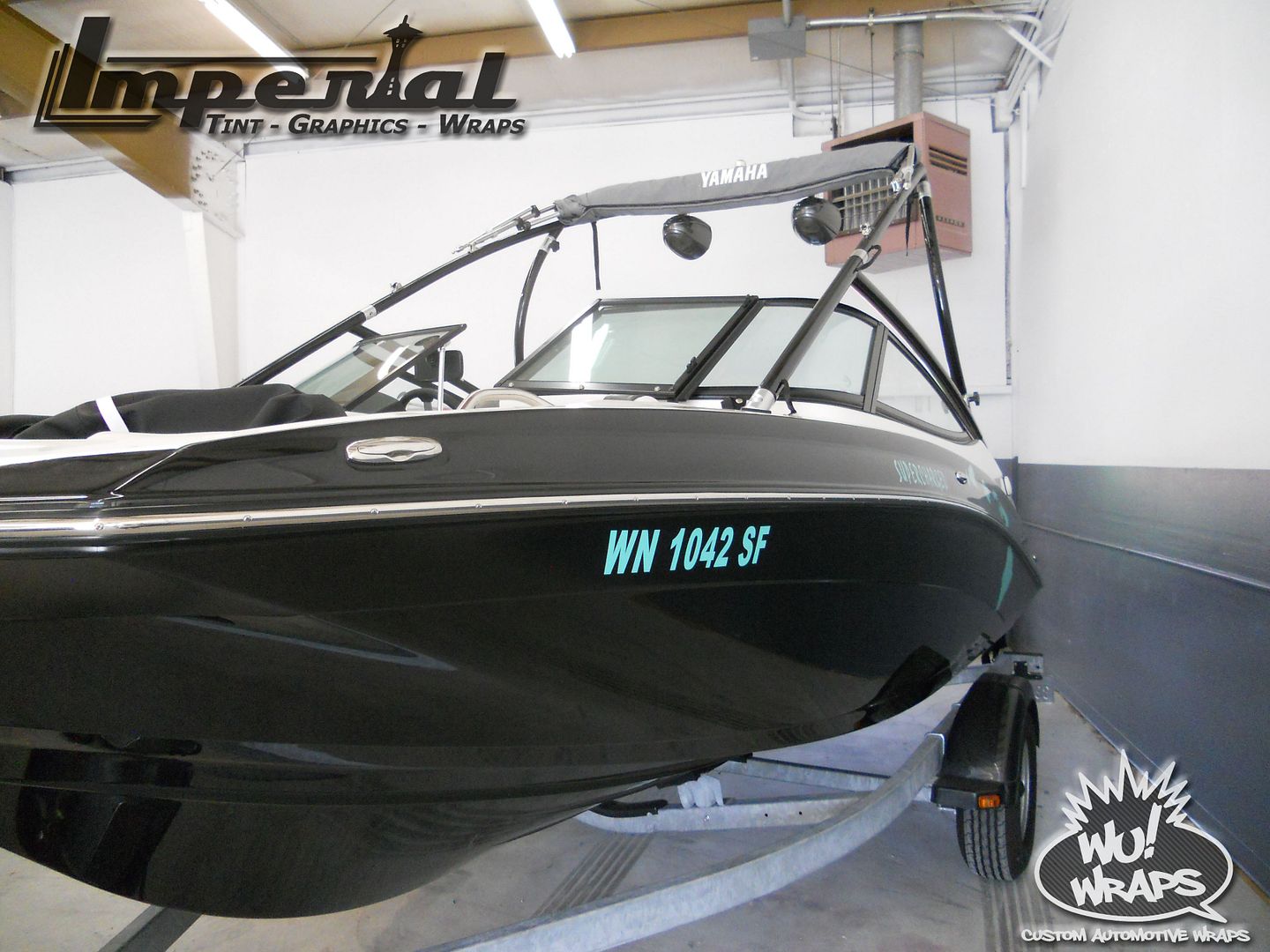

  1. non bike related, wrap jobs are starting to get bigger & bigger!

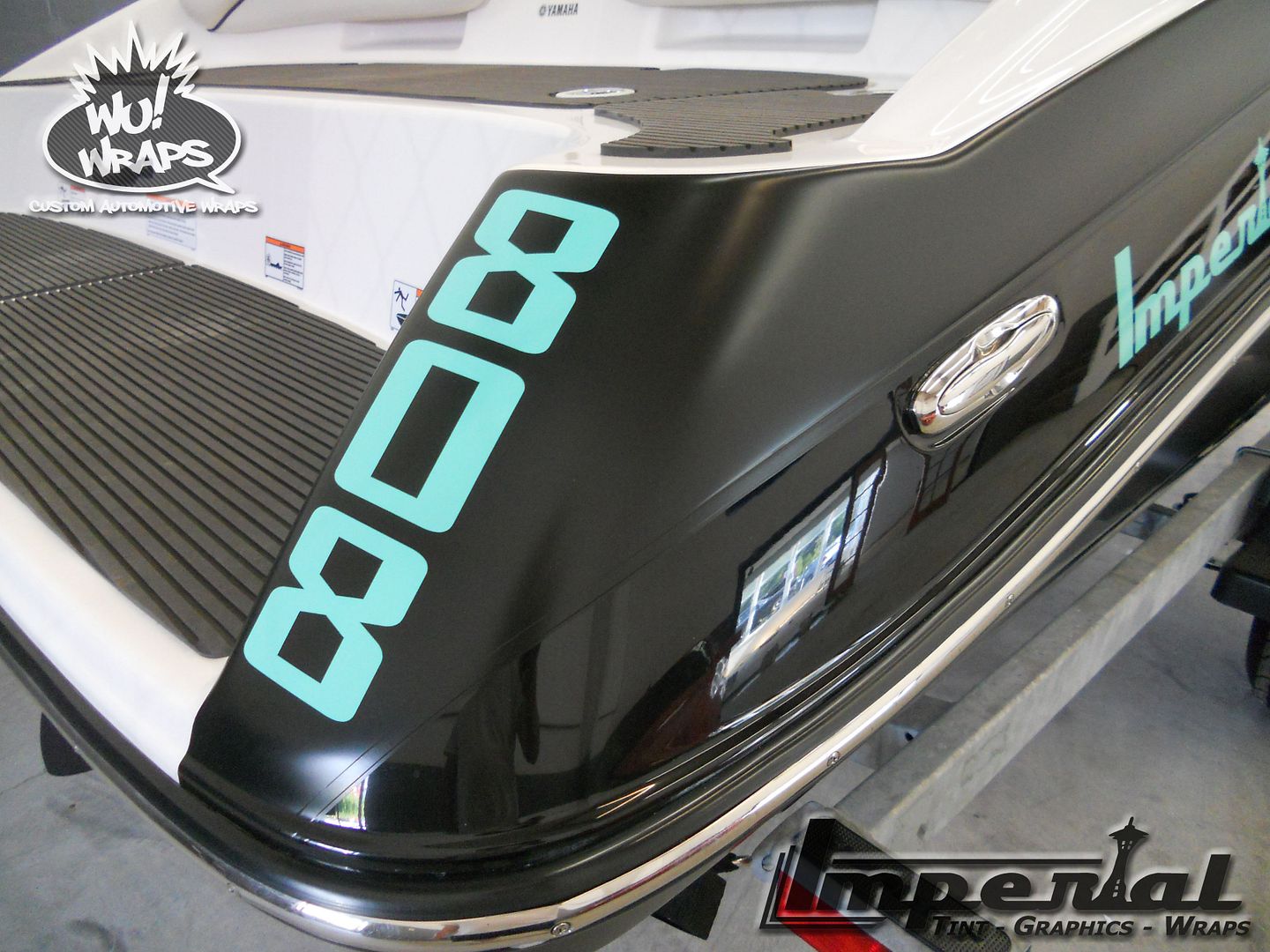

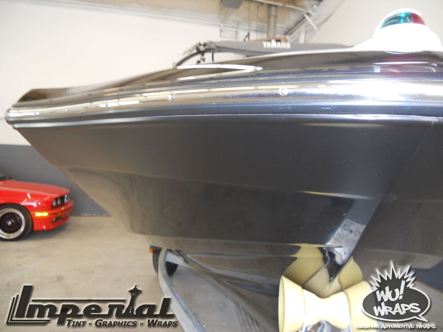

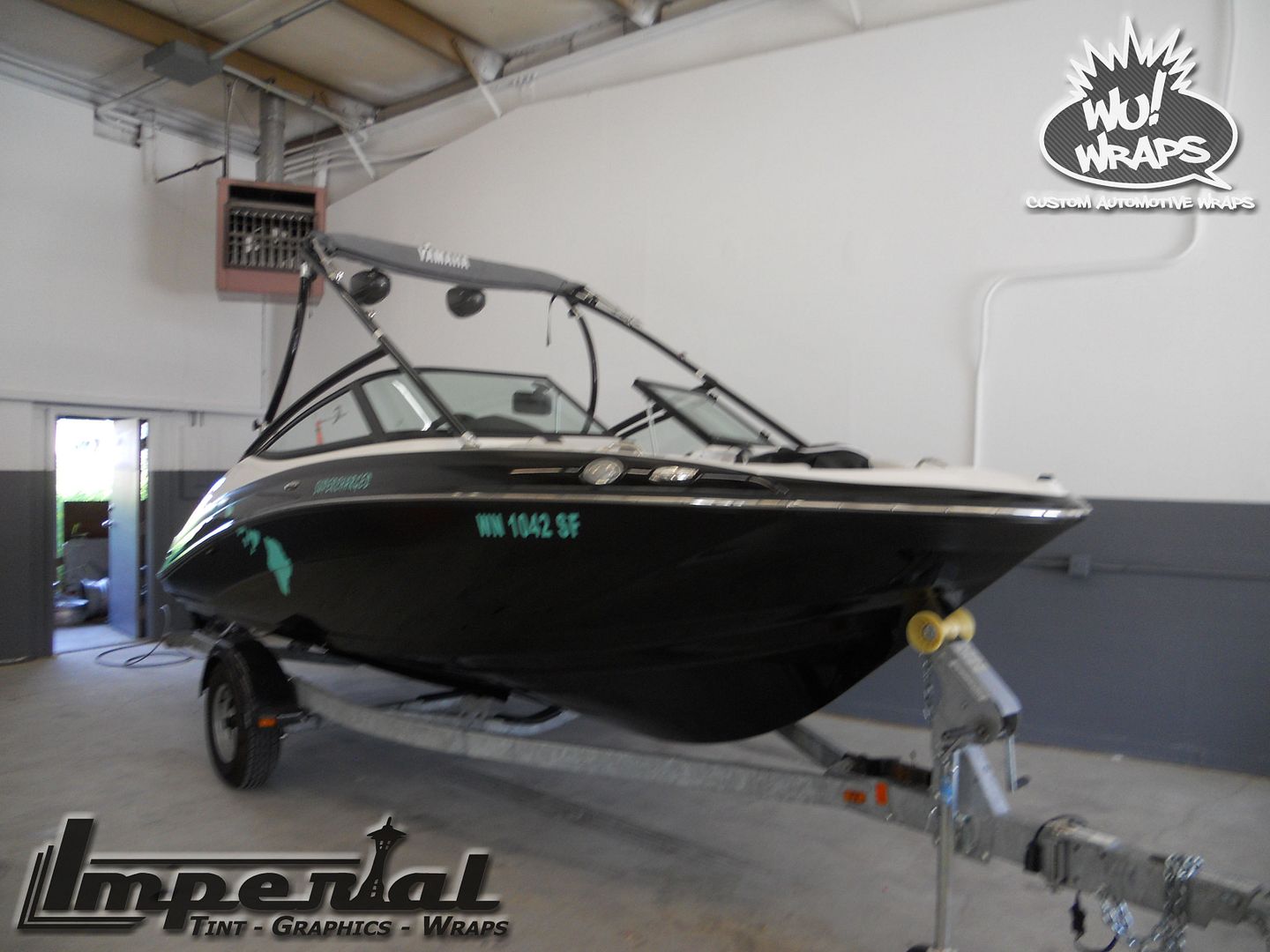

    2014 Yamaha AR192 Avery Supreme Satin Black accents vinyl wrap Wu! Wraps Imperial Tint seattle wa

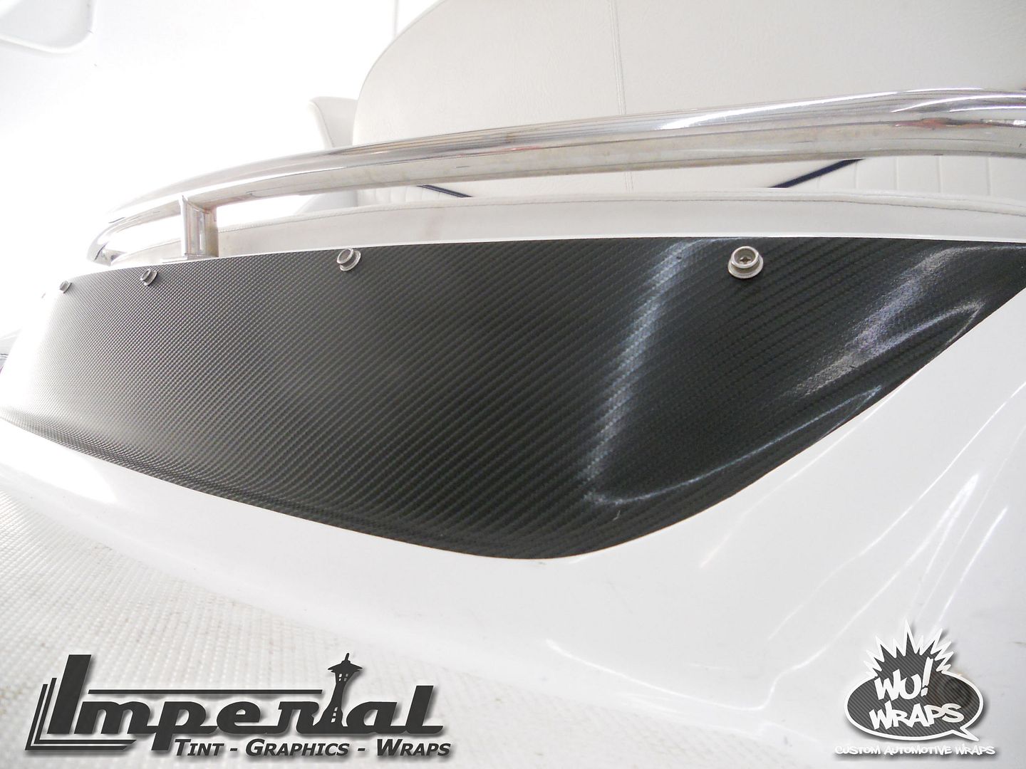

    sup sup, another water sport vehicle wrapped up by Jeff & I! this time we got a 2014 Yamaha AR192. so boat was white with gloss black. owner wanted to add more black to it but at the same time make it more of a accent black color. so we decided to wrap the lower white section just below the beltline @ the upper section btwn the gloss black @ white area. we used Avery Supreme Satin Black! hard to get a good shot of it against the gloss black, one of those gotta see it in "person" type deals! looks legit tho! owner is obviously Hawaiian, so Jeff did some decals to represent. owner is stoked! lots of prep work involved with a job like this, peel off old decals, clean old adhesive off, clay bar more adhesive off, tack rag wipe off any left over adhesive debris, mock up a TON of knifeless tape, cut patterns, wrap, lots of post heating time, then edge sealer along areas submerged in water, then decal work... total job time on this one was about 12-15hrs or so. Wu! Wraps Imperial Tint Graphics Wraps

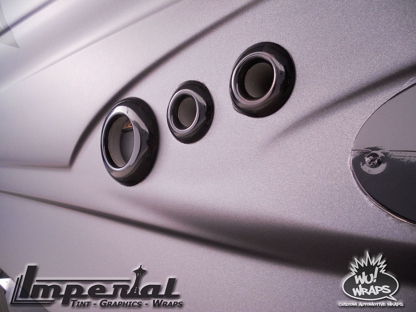

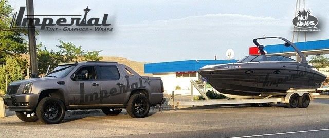

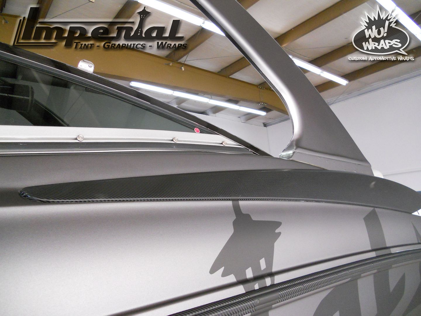

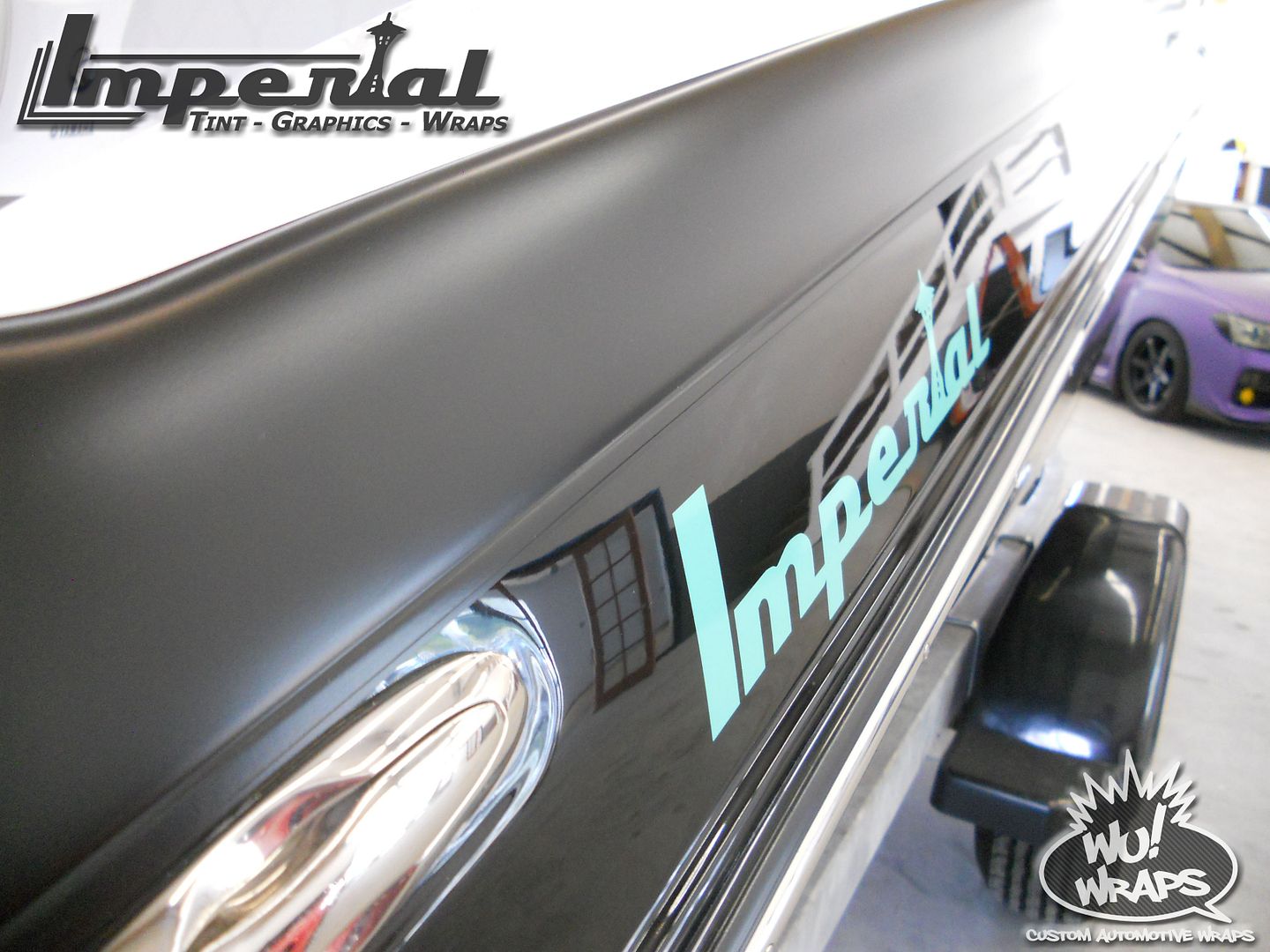

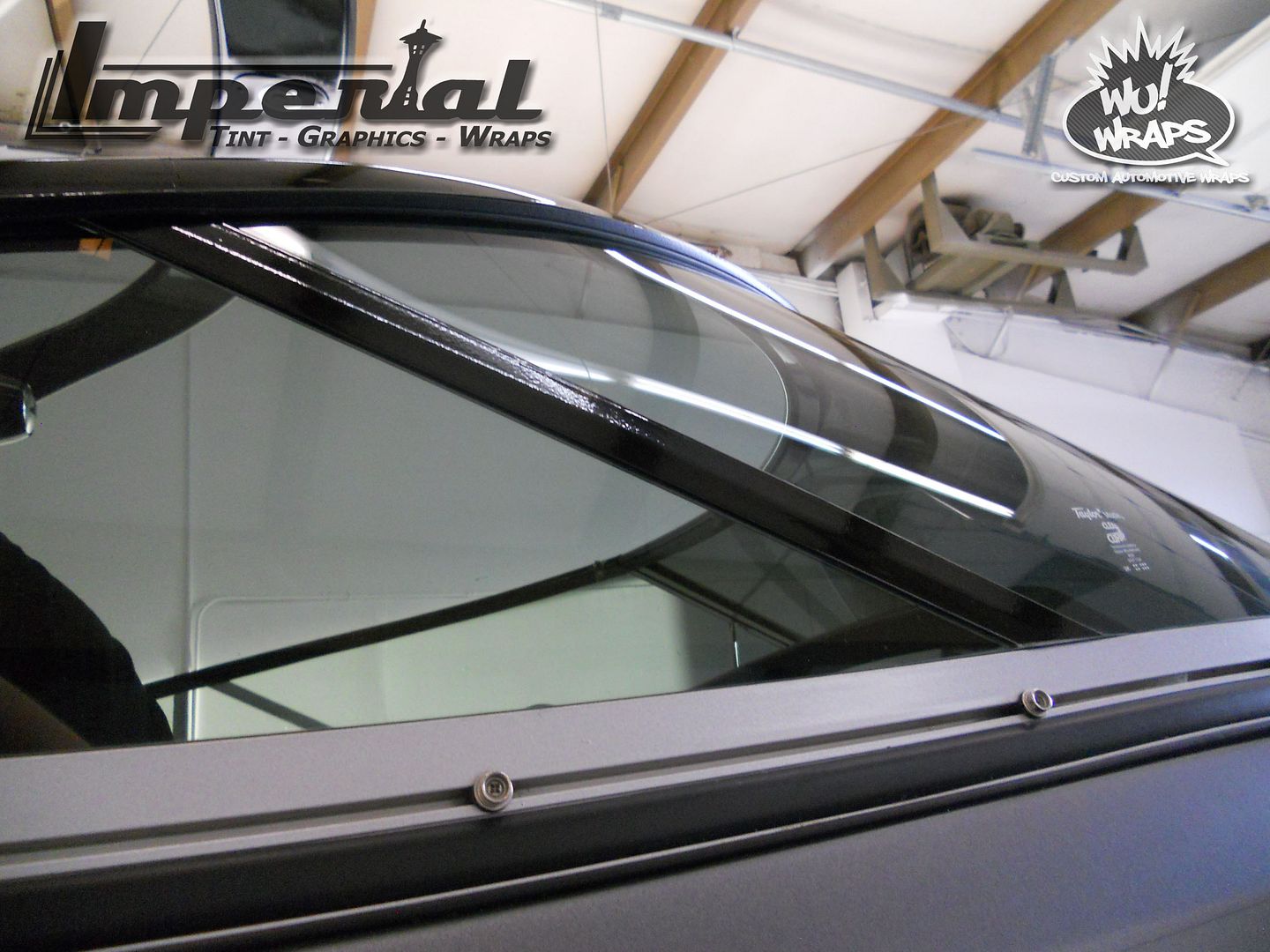

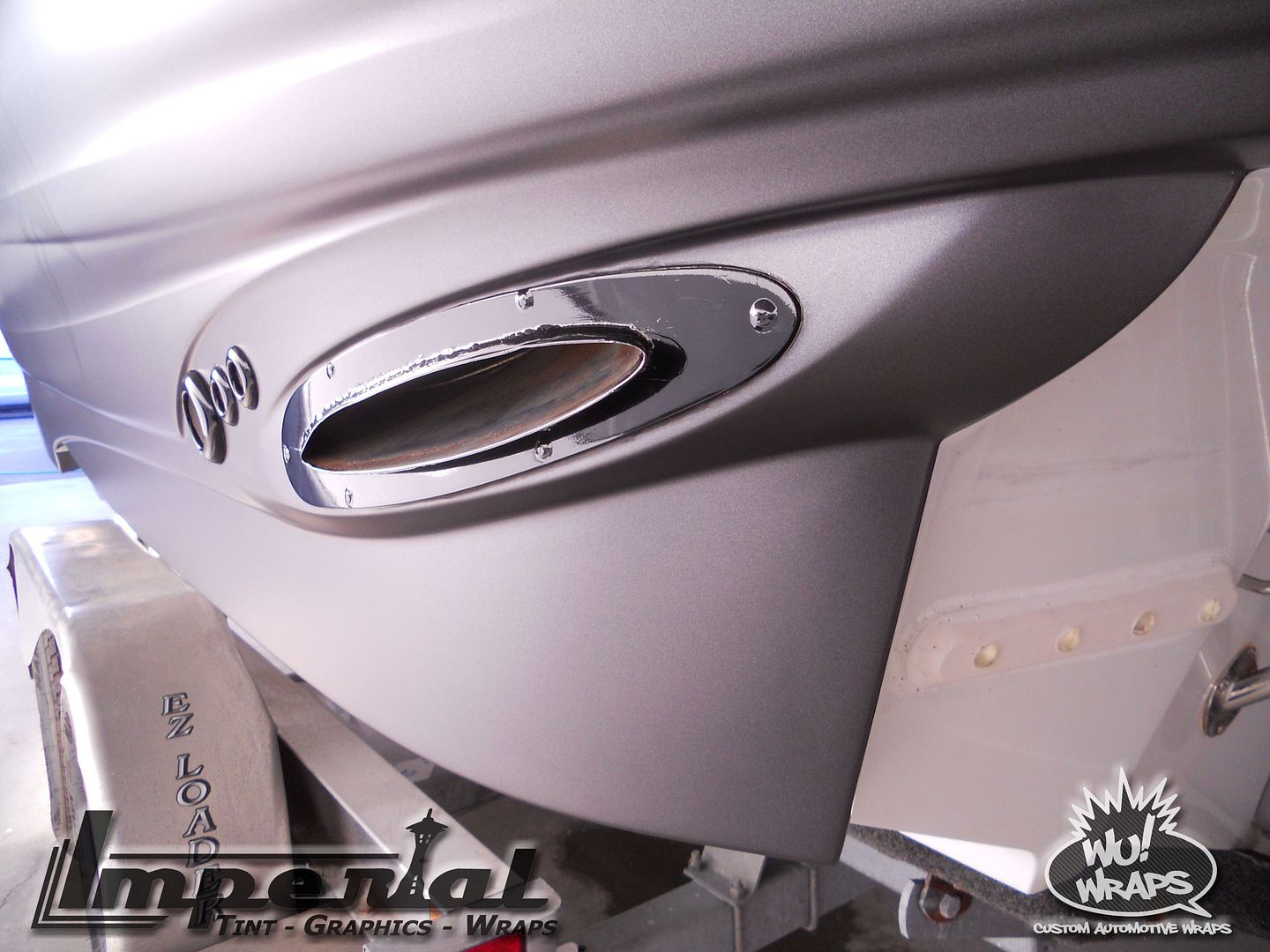

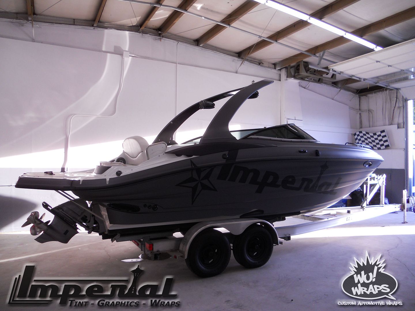

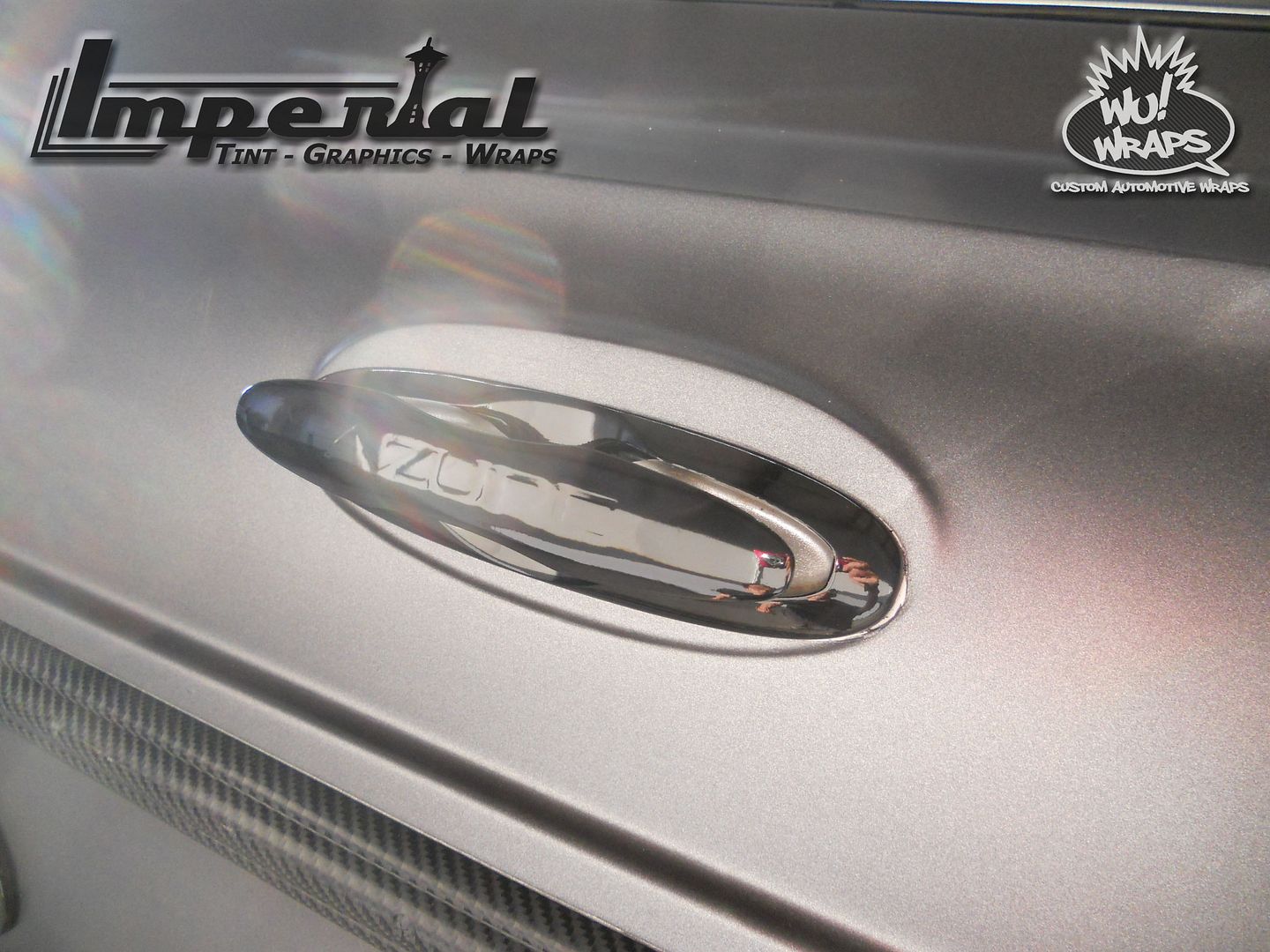

  2. non bike related, but i think this is the BIGGEST job we have done to date! lots of hrs in this one...
    2009 Azure 30' Sport Boat 3M 1080 Matte Dark Grey vinyl wrap Wu! Wraps Imperial Tint seattle wa

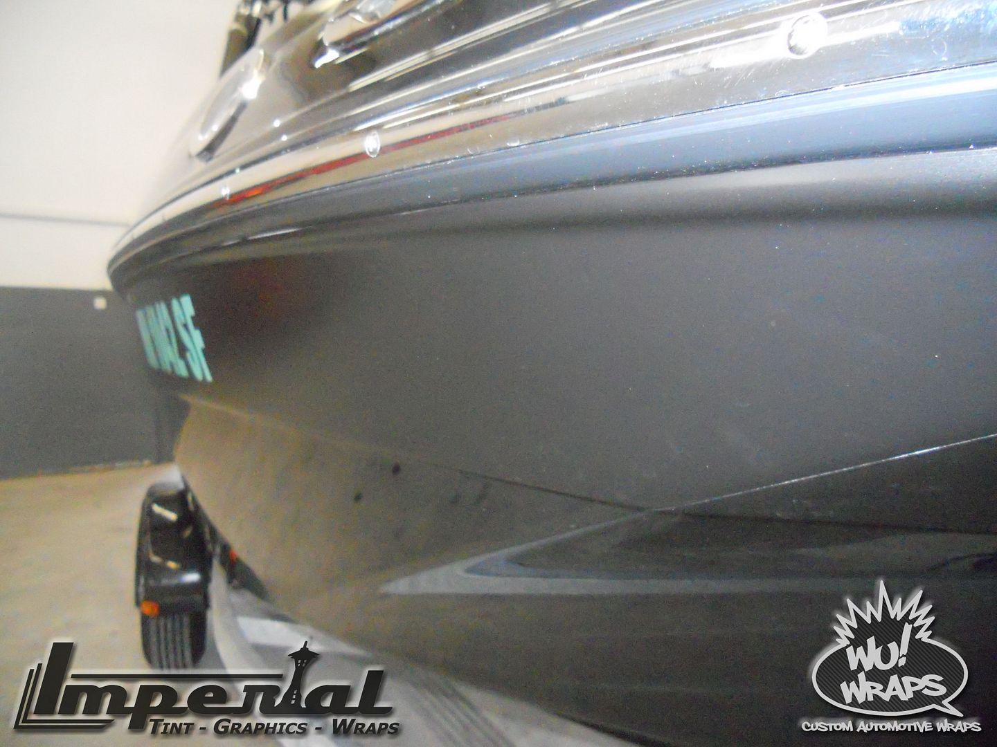

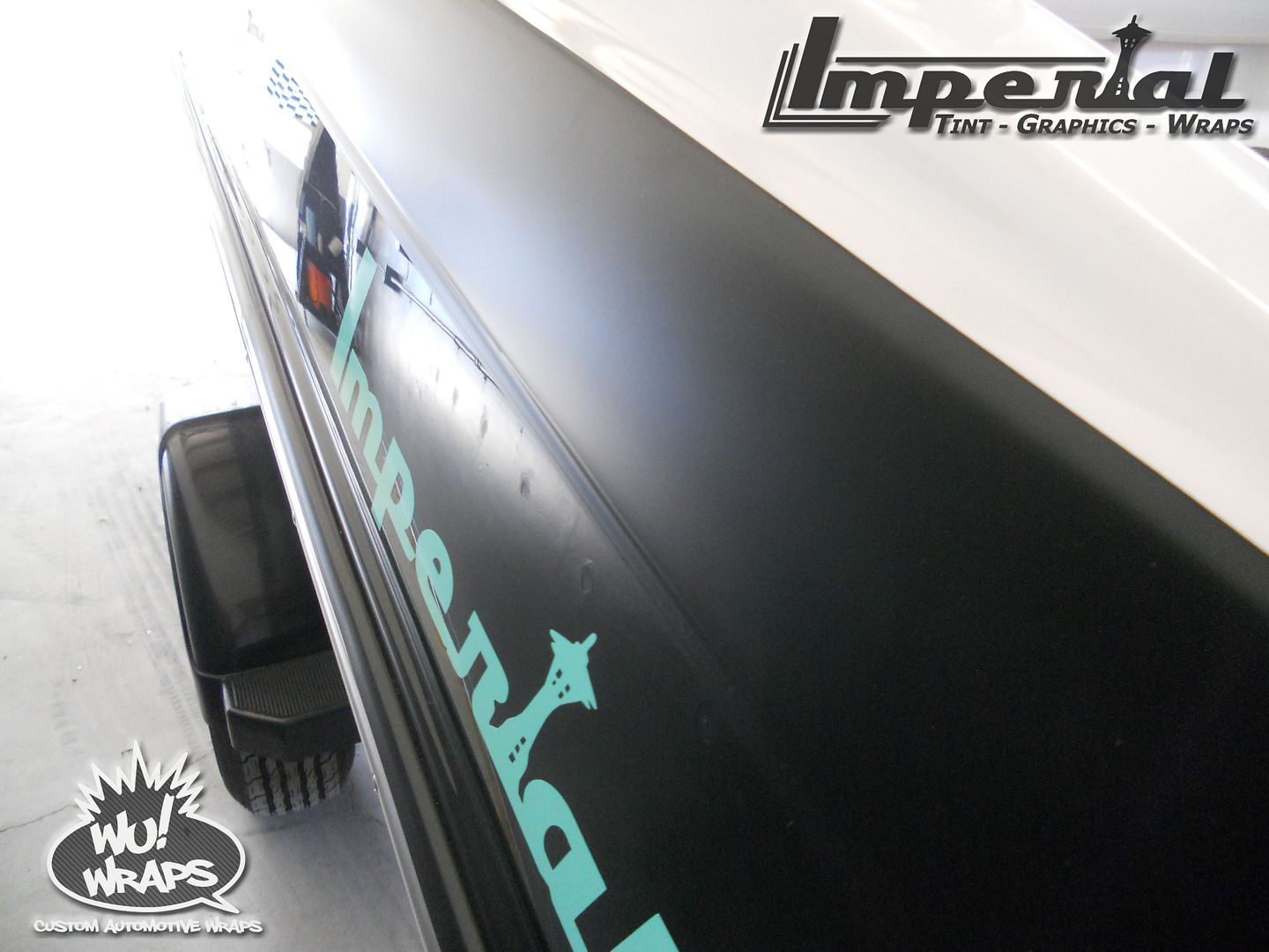

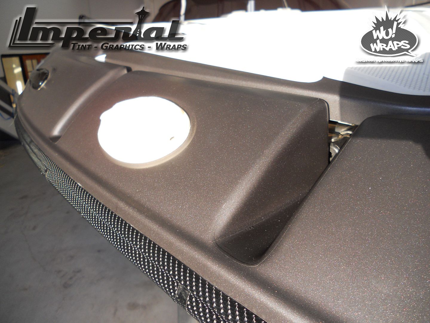

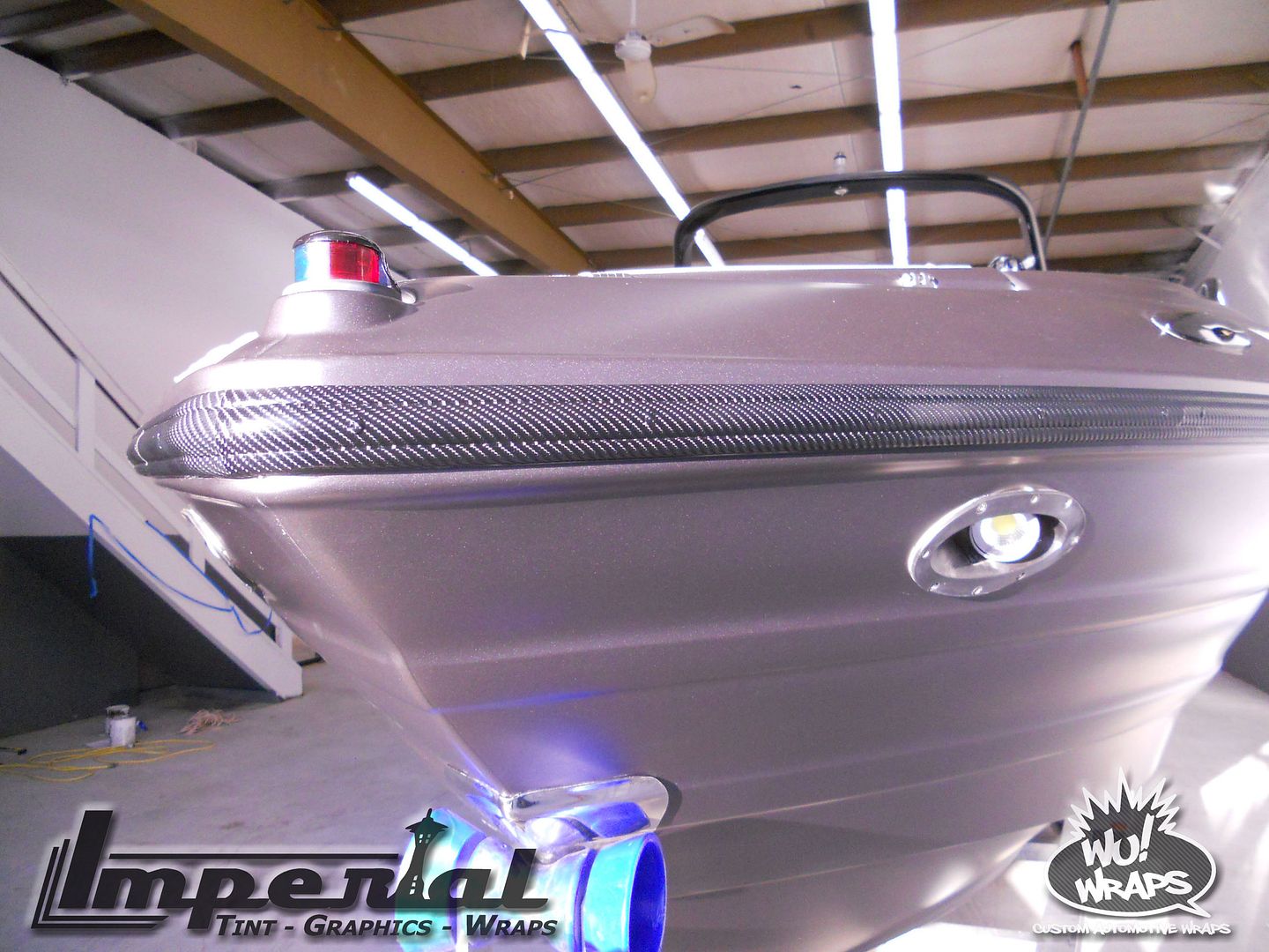

    sup sup, so FINALLY i get a chance to post pics of this BEAST that Jeff & I wrapped up!! this is Jeffs rigg, u buy a boat, u gotta make it match the custom wrapped/ modded Escalade truck that tows this BEAST! =D so, where do we start on this project!... think we went through 5x90' of vinyl wrap for this thing, lots of prep, cleaning, etc... lots of complex curves/humps/dips/rolls/etc... def not for the novice wrapper... we used 3M 1080 matte dark grey for body, gloss blacks for all chorme accents/tower underside, windshield frame,pinstriped our break from grey to white, matte black for the "Imperial" logo, Vvivid Vinyl 4D True R black CF for the beltline, swim deck accent and tower base... came out SICK!!! we got over 70+hrs into this job... probably the longest job we have done to date, but well worth the labor! i'm sure some of you will see this out and about this summer! Wu! Wraps Imperial Tint Graphics Wraps
